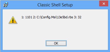

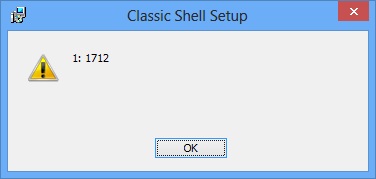

Here's what I have to show and upload. I hope this helps in isolating what this issue might have been. The VM is a vanilla installation of Windows 8.0 Enterprise with latest patches prior to updating to Windows 8.1 Enterprise.

File comment: Errors shown on previous installations
