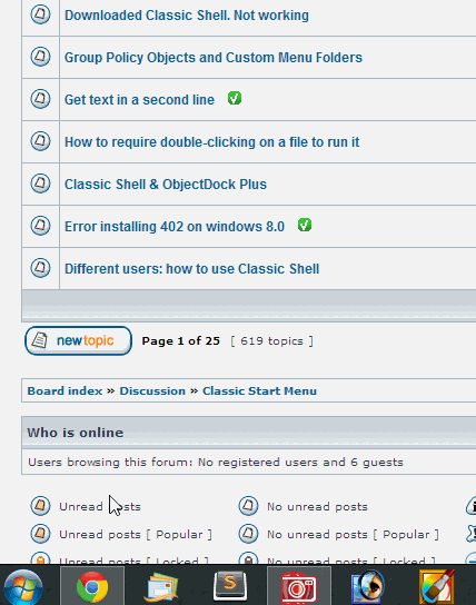

Since yesterday, the search ("Search program and files") stopped working. I do not recall doing anything out of the ordinary.
Basically, what happens is that I start typing, and nothing shows up. Just "Searching...", but it'll stay like that (I left it searching for minutes, it doesn't seem to do anything). Some programs will show up when I fully type out the name, others won't show up at all, no matter what.
For example, until yesterday, I could type in "openc" to have "OpenCanvas" show up, and hit enter to start it. If I try the same now, nothing shows up (just "Searching"), and not even typing out the program name fully will help.
I attached a GIF showing what happens.
