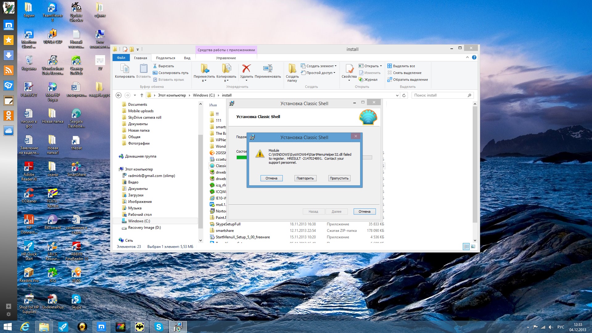

Joined: Wed Nov 13, 2013 11:05 pm
The problem is not detected. problems in your program, unfortunately.
 Post subject: Re: Windows 8.1 Start up
PostPosted: Tue Dec 03, 2013 9:02 am
Which problem? You will have to at least write a proper sentence in English so we can understand what the issue is.
PostPosted: Tue Dec 03, 2013 9:32 am
@radmirb: Looks like there is supposed to be a link to an image in your post, but the link is inaccessible. You can try adding it as an attachment.
PostPosted: Tue Dec 03, 2013 11:30 pm
win 8.1
http://forum.ru-board.com/topic.cgi?for ... tart=360#9
Безымянный.jpg [640.28 KiB]
Downloaded 5557 times
PostPosted: Wed Dec 04, 2013 12:15 am
Just like I said in the other forum, this error means "access denied". I recommend using a tool like Process Monitor to identify exactly what operation is failing. If you don't know how to use such tool you need to find someone who does. My guess is there is something wrong with the permissions in the registry.
PostPosted: Wed Dec 04, 2013 1:18 am
I run the setup file as an administrator. moreover, the user on the computer and it is one the administrator.
We will look for errors in the registry.
sorry for my english))
PostPosted: Wed Dec 04, 2013 1:21 am
@radmirb, You could use a freeware like Unlocker to determine what is locking the DLL: http://www.emptyloop.com/unlocker/download.php Don't use Unlocker to forcibly unlock it, but only to see which program is locking it. Then exit that program and try installing Classic Shell again.
PostPosted: Wed Dec 04, 2013 10:14 am
Even admins get "access denied". Permissions can be denied for admins too. However an admin has the permissions to allow himself access. But for that you need to know which resource is denying you access. Until you find that out, we are just speculating.
