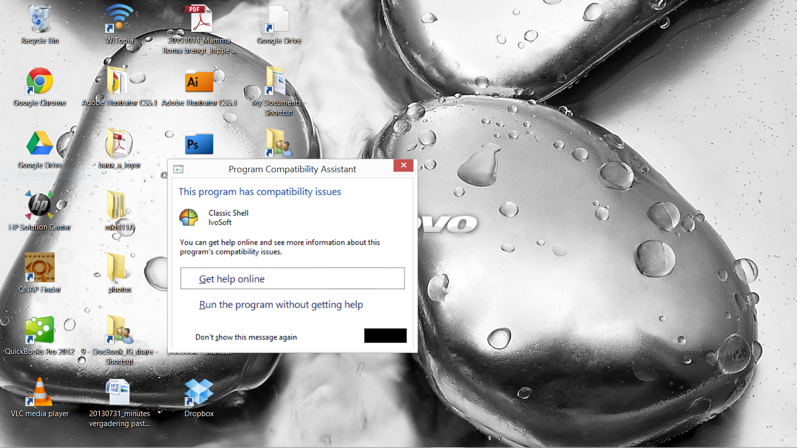

thx for the feedback. More seems to be going on than just a desktop setting... See attached for another screenshot, where there is referred specifically to something compatibility related.
In summary: since updating my pc to win 8.1, my desktop is unsharp / hazy. It goes further than just the desktop: everything launched from the desktop is hazy as well.
Only the metro interface, and all the applications have a good 'sharpness' level, just a i used to have prior to the upload.

It appears that the "Program Compatibility Assistant" is not DPI-aware, so the system stretches it up, blurring the text. It is also possible to achieve this effect by having multiple monitors with different DPI settings (a new feature for Windows 8.1), then launching a program on one monitor then moving to another. If the program is not multi-DPI-aware, then it will be scaled on one of the monitors.
BTW, It appears you are trying to run an old version of Classic Shell (like 3.6.7) that is not compatible with Windows 8.1. The recommended version is 4.0.2.
