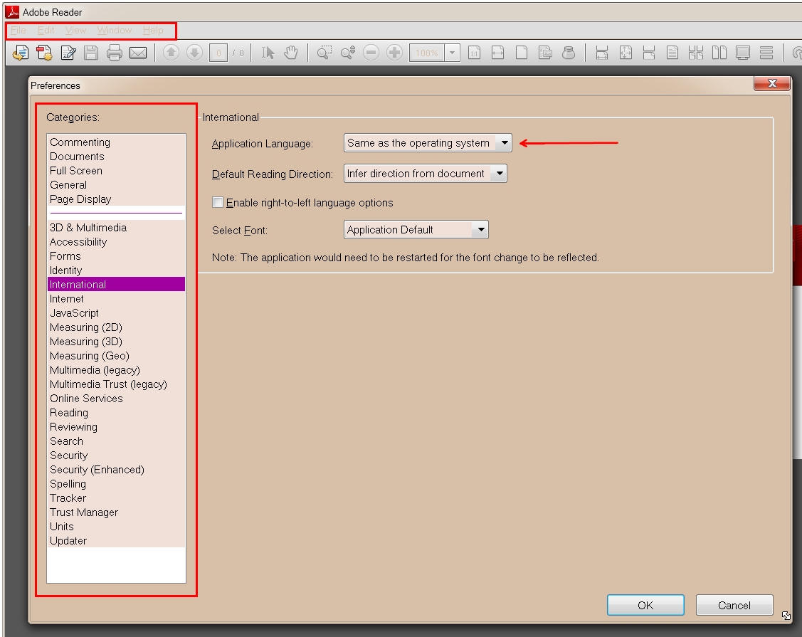

Believe me, You can try to use Control panel to achive exactly same result :) Before using direct registry change i've carefully observed system canges made by cp applet via procmon (registry and file changes).
Moreover, other software detects UI language correctly (for example, take a look at Adobe Reader screenshot below).
