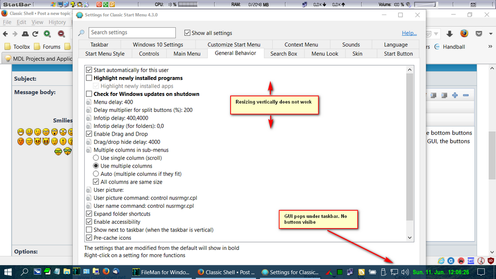

I am running W10 using medium dpi settings (120 DPI) and the settings menu always pops under the taskbar and the bottom buttons are not accessible. I tried to fix this by resizing, but that only works for horizontal and not for vertical. If I maximize the GUI, the buttons become visible, so I set the properties for the shortcut to open maximized, but CS is ignoring this property on launch. Any chance this can be fixed?
Edit: Same problem on W8.1
PostPosted: Sun Jun 11, 2017 5:48 am
The maximized window for Settings will be remembered in the next version of Classic Shell.

Thanks. Is there a specific reason for not being able to resize vertically and for the pop-under behavior of the GUI, or will that also be fixed?
PostPosted: Mon Jun 12, 2017 8:59 am
I think the Start menu style tab needs a minimum vertical size, although I guess the Start button settings on the style tab could be moved to the right of the styles instead of below (since most Windows PCs have horizontal screens). That would place restrictions on the minimum width of the Settings window though (which I think would be OK).
Although only Ivo can definitively say.
