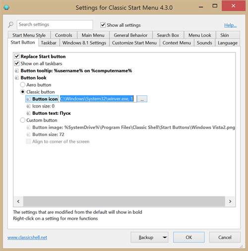

PostPosted: Fri Dec 02, 2016 1:51 am
Yes it's possible. Set the Classic button first. Then go to the Start button tab.
There is a separate "Button ICON" setting for the Classic button. Select it, then press the [...] button to pick an icon.
You will find the Windows 7 icon in C:\Windows\System32\winver.exe.
You can adjust the icon size too and button text as well.
