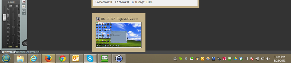

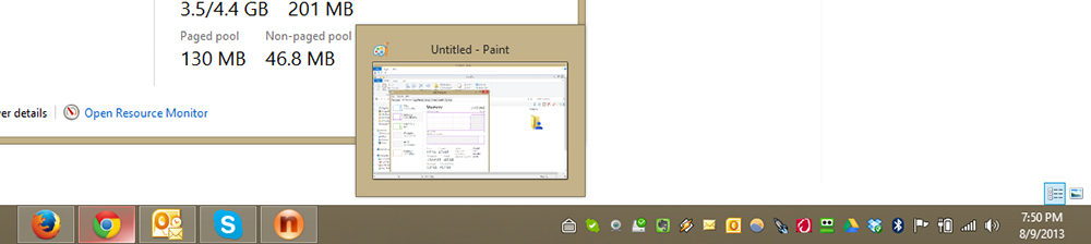

Ok so I finally looked down tonight and saw the clock says 7:50pm and it is like 9:30pm
I got some screen shots for you- the icons on task bar to right are 1 off and the icons to left are not showing some programs that are actually open. I will try to leave it like this to see if there is any info I can provide while the issue is present.
One pic shows when mouse is over a prog that is not showing- the Windows aero preview or whatever still works. The other photo shows how the mouse is over the Skype icon but is displaying info for Trillian which is to the left of the Skype icon.
Thanks!
C
edit- just added pic of overlap- occurs when CS is closed and reopened. thx
Also- CS is updated after restart but stays frozen- ie- the icons and time change but continue not to update

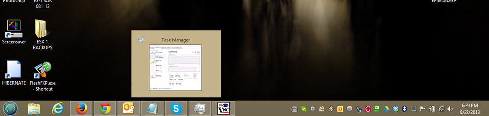

Same issue with v3.9.1
left the computer sitting for a few hours- no sleep/hibernate, did have a VNC session that closed on it's own. Frozen taskbar. Restarting CS does not fix, but restarting CS and Windows Explorer seems to work.
File comment: after closing CS and WExplorer and restarting both
File comment: after closing/restarting CS
File comment: frozen

No it still works but you might have a program showing it is open when it is closed or have an open program but only blank space on the taskbar. If you click it will work. It just seems to freeze in terms of display. Imagine if the display froze- and you closed or opened programs- the taskbar has them all wrong and does not respond visually to rollovers but the Aero preview works and clicking works.

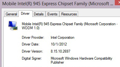

Ya had this machine for years and Win8 for almost a year never had the issue previously. I could run a debugger or something if you think that might help determine what happens. Maybe gpu driver? Thanks.
C
FWIW:
